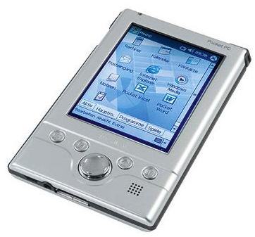

This sounds like a fun project if you can pull it off. The idea of having a fully self-contained electric guitar with onboard electronics is very appealing to many of us.
I couldn’t find any specs for power requirements in the tech data for the Nano, but I suspect they may be high enough to give you a choice of very short untethered times or keeping your guitar plugged in full-time.
If I were going to approach this project I’d cannibalize a pocket PC. Prime candidate? Toshiba e series. The e330 can be picked up for 50 bucks or less on ebay.
It measures about 3 x 5 inches and is about ?-inch thick. It weighs less than 6 ounces, gets about 5 to 6 hours on a fully charged battery. It has enough processing horsepower that it could run your effects, provide a drum machine and display your set list all at the same time. It uses SD memory cards, so storage is no problem. The OS is Windows PC 2000, (same as Windows CE 3.0)
I have one of these and use it much more than I thought I would.
Now that I'm thinking about it, why limit this idea to a Les Paul? Why not a Chet Atkins-style guitar that's equipped with both analog and midi pickups and uses the e330 programmed as a soft synth
